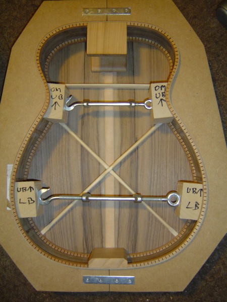

Phil, this is the X-braced Walnut back, it's a pattern I've used a lot and like it, I do use a Spanish foot as you can see so that should count as a brace as well. I haven't got any open pics of my top bracing carved, I'll post some when the OM is done. My brace dimensions are 6mm wide on everything, X is 15mm tall, tone bars 13mm & 11mm, finger bars, 10mm & 8mm.

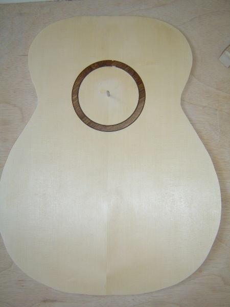

This is the Italian Euro top, from Luigi, absolutely stunning piece of wood, probably end up so thin you'll be able to see through it!

ColinColin S39025.4291203704

Hesh, I also keep the "parabola" of the brace going right until it meets the lining, in other words no end scallop. (I think I said this in a thread some time ago). However, once its under the lining it ceases to affect the top as it is now glued to the kerfing as well, so I just rout out the kerfing with a 2mm pocket and shape the end of the brace to fit the pocket, the rest of the end of the brace, usually about another 2mm will butt up against the lining. Does that make sense? I'll post some pics when I've got the next top ready.
To make this easier for access,I don't actually glue the back on until I have got the top fitted to the sides as well.
